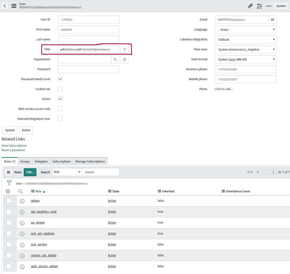

After decoding the token I've identified an item(claim) in the token. Item "sub" contains my AD user.find_real_file.png
In the Auth0, openid-configuration, I checked that "sub" is a supported claimfind_real_file.png
 In ServiceNow (Madrid dev) environment I've configured a External OIDC Provider. The Client Id and Secret are copied from Auth0
And in the OIDC Provider Configuration User Claim "sub" is mapped to (sys_)user field Title.
(From what I understand is; that the value in sub is checked against the field Title in the sys_user table)
 I've also created a user, where the Title field contains the value of my AD user. I've also added some roles to the user.
 But when I call the Table API, with the external token, I get a 401 Unauthorizedfind_real_file.png
So, yeah. I do think that it is possible to use an external token, and I feel that I'm close. But I can't seem to figure out how it works.
