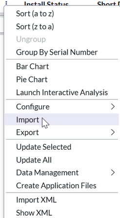

I'm trying to import a excel sheet by using Import option in a ServiceNow table.
We have a field called "DEP registered" which is a read-only field and the type is boolean(true/false).
When i'm importing it is not working, its showing disable instead enable, is this OOTB behavior?

@sattar3 Easy import will not work for Read only fields, a similar topic is discussed on this thread here https://www.servicenow.com/community/now-platform-articles/easy-import-functionality-don-t-work-when...
To address this issue, make the field editable and enforce the Read only behaviour via field level write ACL.

Hello @sattar3
- As @Sandeep Rajput mentioned, the issue you're encountering is due to the 'DEP registered' field being marked as read-only.
- Because of this, even though you're importing data directly into the table, ServiceNow does not allow updates to the field.
- To resolve this, you’ll need to temporarily make the field writable during the import process.
