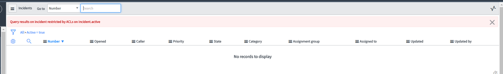

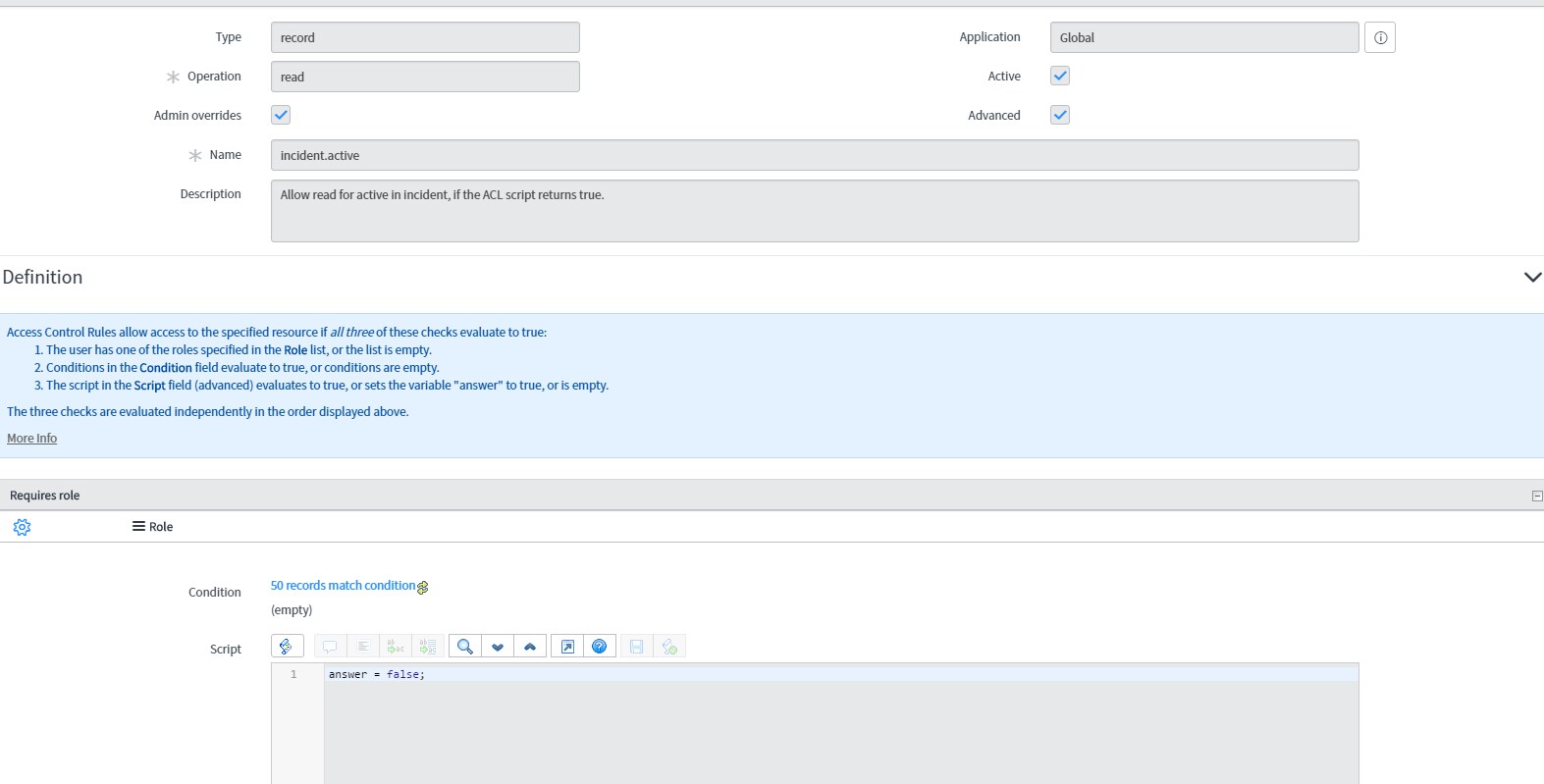

Basically going into the table record and then the dictionary record for the field and un-checking the active box. Save it and reload the list view, go to the filter at the top and you can still pick the field. What is even more concerning is that I can put a script based ACL in place on the field and set the script to just return false but still can filter on that field. The results that come up blank out the field but it is still returning results. If I put in a role based ACL then the field disappears from the filter options and also from the list view. Finally even with the role base ACL in place, if I use the URL to create the query it again returns results as if the ACL didn't exist.
‎07-08-2016 12:00 PM
Hi Joshua,
Is this true for any field on any table or just active on the table displayed in the image? If it is system wide, I suspect a property somewhere (that I'm not familiar with).
