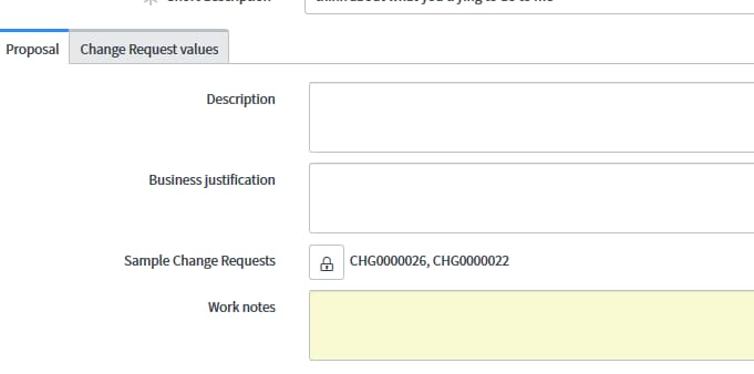

I am trying to run this script on a business rule on the std_change_proposal table but nothing is being returned in the while loop.
    //u_m2m_std2chg
    var chgs = [];
    chgs = current.change_requests.toString();
    chgs = chgs.split(',');
    while(chgs.next()){
        gs.info(chgs.getDisplayValue());
})(current, previous);
I am trying read from the list in Sample Change requests
