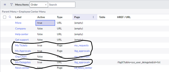

I've got a Main Menu on my portal called 'Employee Center Menu':
I've set up three menu items that I'm wanting to add the main header menu:
However, what I've noticed is that they're being added next to a taxonomy menu rather than higher up in the header (highlighted in red):
So i was just wondering if somebody could explain what I'm doing wrong and I get those three options moved to the heart symbol.
