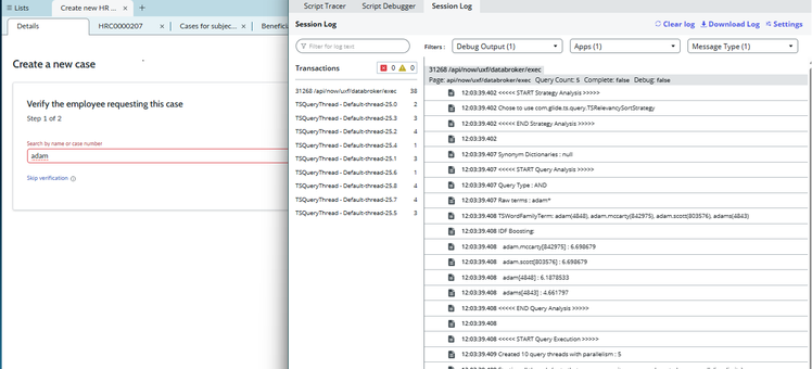

03-18-2026 06:08 PM - edited 03-18-2026 09:03 PM
I only got the error message to show up once here but not sure at what stage it happened. The message itself is generally displayed when you do a text search using search terms that are only stopwords or return too many wildcard matches). The default amount seems to be 500 indexed words (sysprop glide.ts.max_wildcard_expansion).
So if you search for adam like in the original question, you will actually search for a list of tokens that match the root you used and the locations of the records that have the words. So if your term is ambiguous you get too many results to use in a search.
Searching for adam will look for anything with root adam so if you have many adams you will have too many results. Matches from my pdi: adam(4848), adam.mccarty(842975), adam.scott(803576), adams(4843)
You can turn on debug text index and trigger the error message. Then in the debugger session log you should be able to see what the term is that is causing the error. From there it should be easier to find the root cause and come up with a resolution.
The script include used for the search by the controller for the typeahead component on that page is actually editable:
/sys_script_include.do?sys_id=687d7d8deb6f3200a9e7e26ac106fee0
You can see from the search method that it uses the this.TEXT_QUERY constant with value "123TEXTQUERY321" for the query as in it does a keyword search
