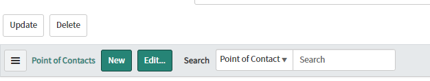

I have two tables with a many-to-many relationship (Customer & Point of Contact), and have a sys_m2m table related to both of them.
When an admin signs on, the "New" and "Edit" button shows on the table at the bottom of the form. (see screenshot)
When a regular user signs on, the buttons do not appear (see next screenshot). I have roles assigned to the users, and the ACLs for both tables that allow create/edit/delete/read are assigned to those roles.
It appears to me to obviously be a role/rights problem as the true admins can see the buttons and use them.

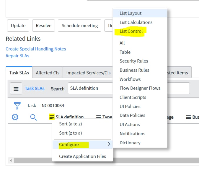

HI Robert,
From your 'point of contact' related list > click on configure > list control
then have a check on this fields highlighted from the below option :
I hope the above steps help, if not then please have a check on role,ALC.

‎12-18-2021 08:40 AM
So you have ACLs that would control this and if you've done all your checks and balances and it should still appear, then it's "list control". So use the contextual menu > list control and you'll most likely see some sort of omit new and/or omit edit with some conditions there or roles assigned in the settings, etc.
