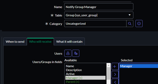

I have a requirement to notify Group Manager when new group is created.
Any suggestions on the this requirement using Events

Dr Atul G- LNG
Hi @Gousia Nabi
If I understood, you want to notify the group manager when a group is created.
You can use the email notification. on group table
and in to whom it send
bring the manager on right side

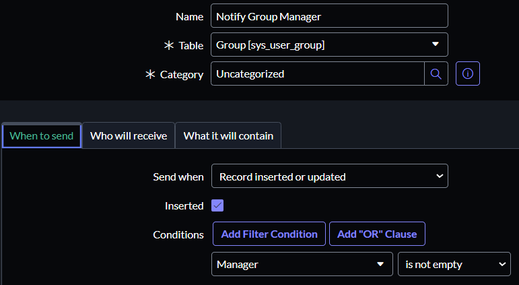

Under when it will send
add condition for group manager is not empty
@Maik Skoddow Already shared screen shot for reference.
