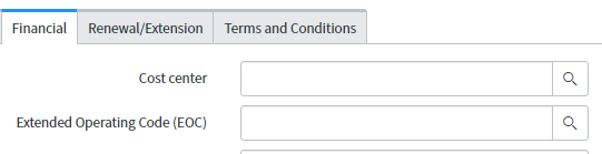

We have a requirement where a filed needs to change based on another field.
If "Cost center" change then "EOC" should display the "list of codes" based on selected "Cost center"
I'm a novice at scripting. Any help would be greatly appreciated.

We have these 2 fields. EOC should list codes based on selected Cost center
1 cost center have different codes

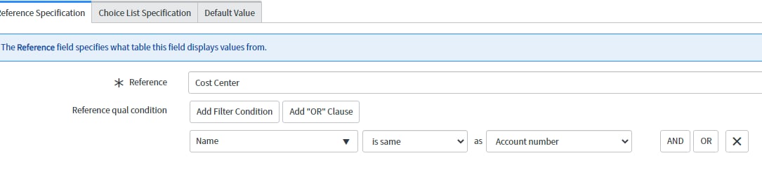

I tried like this but doesn't seem to be working:
Suggestions?

You can try something as below (sample script).
Create a Script include as below.
var getEOCCode = Class.create();
getEOCCode.prototype = Object.extendsObject(AbstractAjaxProcessor, {
    getEOC: function(costcenteris) {
		var finalis=[];
        var yis = new GlideRecord('yourtablename'); //replace correct table nae
        yis.addQuery('sys_id', costcenteris);
        yis.query();
        while (yis.next()) {
          finalis.push(yis.eoc.toString());//replace eoc with correct field name
		return 'yis.eoc.sys_idIN'+finalis; //replace eoc with correct field name
    type: 'getEOCCode'
Pass the reference qualifier on the EOC field as
javascript: new getEOCCode().getEOC(current.cost_center);
//replace cost_center with correct field from the form.
