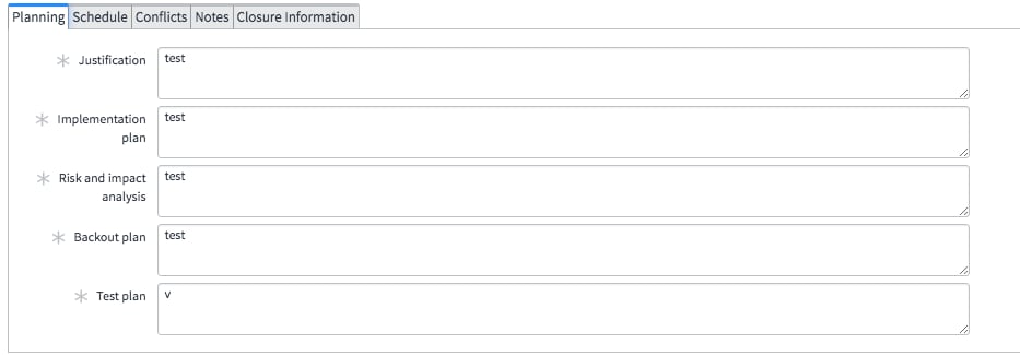

Current Tab Order Attached.
Challenge at hand
1. Create New Change - Normal
2. Display ONLY Planning Tab.
Appreciate the help.

Hi James,
First of all, if you are using Fuji or later version, you do not have to write that section[].style.display. You can simply use g_form.setSectionDisplay('tab_1', false). Please refer the blog which I have mentioned in my last response.
I think, the tab was not getting hide or display=false because of the fields. The field(s) which is available in the tab remains mandatory causing tab to display, even you have written the code to hide.
I hope this helps.Please mark correct/helpful based on impact
