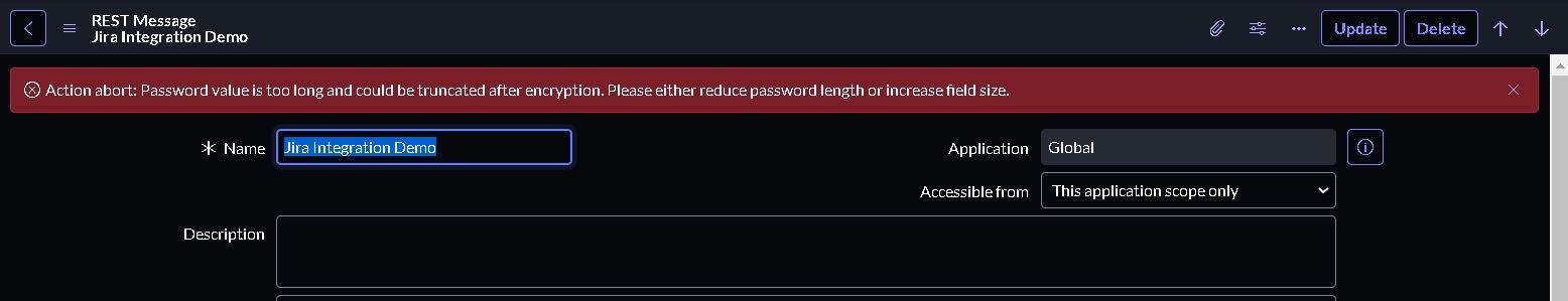

I have to integrate Jira nad ServiceNow using Basic Authentication and for that the length of the token key generated from Jira is very large which is not accepting in the basic auth profile and it generates the error as follows -
When I changed the length of the password in discovery_credential table to 2000, it is still showing the same error. I do not know if the length increased or not.
How to solve this issue?

Having same issue even if I updated the max length but still action is going to be abort.
Can anyone know the solution?

Try the same as you described but looks like even if you change the size of that type in discovery_credentials table there's some background size value which we cannot change.(check following attachments).
