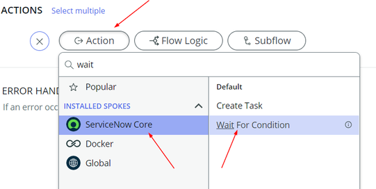

You could use a "Wait for" condition:
With that condition the Flow will only continue whenever the condition is fullfilled.

So its not really when the flow errors, correct? It's more the situations which you already identified as exceptions and have if else / else in place? What you perhaps could do like Maik shared: Wait for condition. If the condition meets, the flow would proceed. In your flow could then add additional logic or perhaps use the Go Back To action.
Haven't tried such as setup, though guess this is only a few minutes work to try out, so give it a go.
