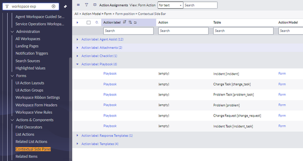

He meant this link: Playbook in CSM Workspace
Which suggests to create a new config on this list of records under the "Contextual Side Panel" option... (I haven't tried it yet, I'll report back):
Good luck!
