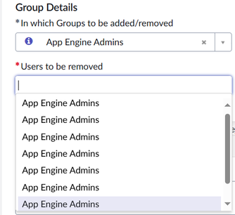

In catalog item there is a
field name: In which Groups to be added/removed (this is Reference Field)
Field Name: Users to be removed (List collector)
So the requirement is: what ever group is being mentioned in "In which Groups to be added/removed"
In the field "Users to be removed" the group members name should be there in the list collector.Capture.PNG
below is what I have done, but with this under the field "Users to be removed" Group name is populating (instead of  group member name)

Under In the field "Users to be removed" the group members name should be there in the list collector, instead of Group name.
Like in the above-mentioned case "Group name" is being populated.
Like in group there is 10 users so 10 times "Group name" is coming but instead 10 group number names should some under the list.

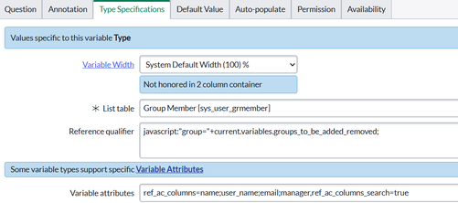

Hi @shubhi_shubhi ,
Your reference qualifier is correct.
The change that have to do it as below:
1. Open the table [sys_user_grmember], then right click and select configure> table.
2. Now, find the User field and set the display value to true
Result will be as below:

Thank you, It solved my issue
