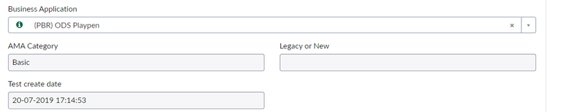

I've got a situation where I'm trying to populate a field called 'Legacy or New' depending on the value of the created date:
I'm wanting to do a comparison of the value of the Test create date field against the value of a system property:
The outcome that I'm wating to achieve is that if the created date of the selected business application is older than 01-09-2024, then the 'Legacy or New' field should be populated to 'Legacy'. Otherwise, the 'Legacy or New' field should be populated to 'New'.
If somebody could let me know what I need to do, that would be great.

@Brad Bowman  It's on a catalogue item when it needs to be displayed

@Siddhesh Gawade When I try and select a business application, I get the error message of 'There is a JavaScript error in your browser console' and the Legacy or New system stays at None
