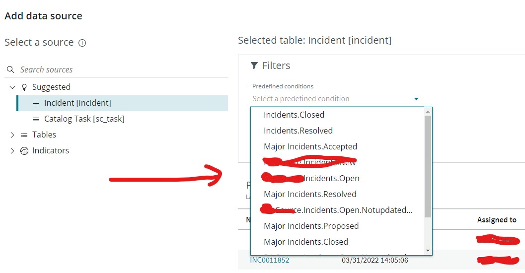

I am not able to find from where we are setting Predfined filters that we can use in Agent workspace. See below existing filter, I need to create new but have no idea where can I do it.

I think those are Indicator Sources.
Please go to Performance Analytics > Sources > Indicator Sources and check if the values you are seeing there are also displayed in that table.

Yes, I see them now, however, what is the difference between Indicator Sources and filter? are they same? Do I have to add it here to utilize?
Hello TT,
As stated in the official documentation:
Indicator sources are data sets consisting of filtered records from one table or database view.
A filter restricts what records appear in a list by providing a set of conditions each record must meet to be included in the list.
So, basically the difference is that the filter represents conditions to apply on top of a data set, while the indicator sources represent a data set already filtered.
That is the main difference between them.

Actually these are report sources
report > administration > report course
if the table matches, predefined filters will appear
