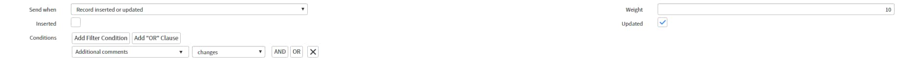

Notification for the requestor has a weight of 10 and send to event creator is unticked. Notification for assigned_to has a weight of 20 and send to event creator is ticked. Should I untick sent to event creator for the second notification?
1st notification:
2nd notification:
Thank you
