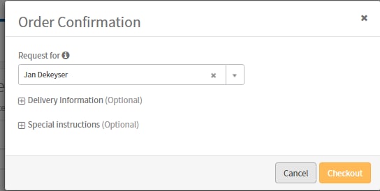

In the catalog itself it works like i want it to work. see below.
But ordering the same on the portal I still have the same as yesterday...???
I want to remove the quantity and the add to cart button. and if possible changing the the order Now button to submit.
Also i want to skip the order confirmation step if possible.
