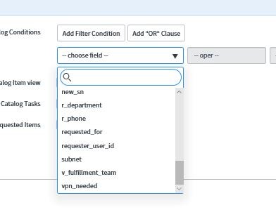

That's what I started with.  The problem is how do I have it only trigger on Closed Complete when I can't locate the state variable with the filters?
HI Brain,
you can see the variable names in the filter in the catalog ui policy and also you can write some conditions like when assignment group changes make it mandatory .
Please include the screen shots of the catalog ui policy ur trying to create.
Hi Pavan,
The problem is the catalog task state field isn't available from the REQ Catalog Req Policy
