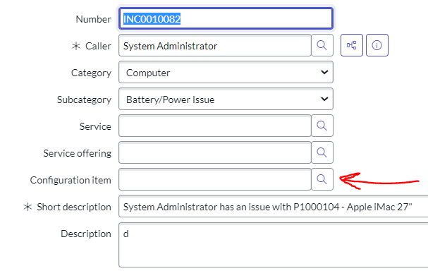

I have created a record producer which currently returns assets assigned to the current user. (see below)
What I am trying to do is pull the associated configuration item off the record that exists for those assets. for example the P1000104 - Apple iMac 27" has an associated CI: Apple iMac 27" - CI
The purpose is so that the CI is automatically populated on the incident record which is created when the record producer is submitted.
I have tried doing this from the scripting area on the record producer and had no joy.

03-18-2022 11:24 AM
Hi there,
No need to use catalog client script or script include here. You can simply use the record producer's script field - something like this should do it:
//set record producer created incident's configuration item field to your Asset drop-down variable
current.cmdb_ci = producer.asset_variable_name.ci.toString();

03-18-2022 11:29 AM
Hi Alex,
Use the following script in the script field of record producer;
var gr = new GlideRecord('alm_asset');
if(gr.get(producer.what_do_you_have_an_issue_with)) //I am assuming that 'producer.what_do_you_have_an_issue_with' will return sys_id of record in alm_asset.
current.cmdb_ci = gr.getValue('ci'); // Populating cmdb_ci field of the incident table with ci field of alm_asset table.
Hopefully this will work for you as it is working on my PDI.
03-21-2022 02:21 AM
Hi Muhammad,
yes this worked perfectly. Thank you so much 🙂
Alex
03-21-2022 03:17 PM
There no need to make the GlideRecord call in your script, since the variable itself is a reference to the alm_asset record you can accomplish the same with one line of code and dot-walking -- see my first answer above:
If this answer is helpful please mark correct and helpful!
Christopher Perry
