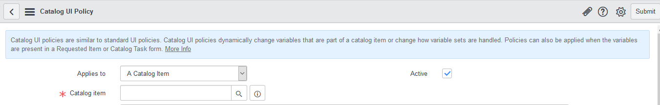

In that case, you just need to create a Catalog UI policy with Applies To = Catalog Item and Catalog Item=name of your catalog item.
Save it. Then create a UI policy action for this UI policy, select the variable name and set Mandatory to true.

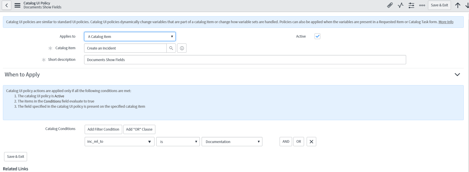

I have the following Catalog UI policy
This makes the label and checkboxes display
I then created another Catalog UI Policy which was intended to set when the label field would be mandatory.   Therefore I need a condition to say that the label becomes mandatory when the label become visible i.e. when inc_rel_to = documentation and that it is only mandatory when all the checkboxes are false.   If any of the checkboxes become true then it is no longer mandatory.
