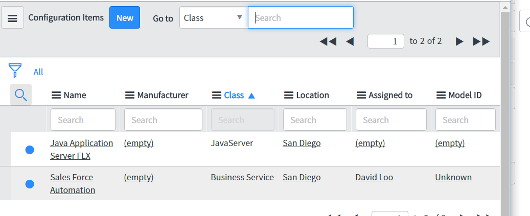

I have 2 CI based on location Sandiego.
Harish
