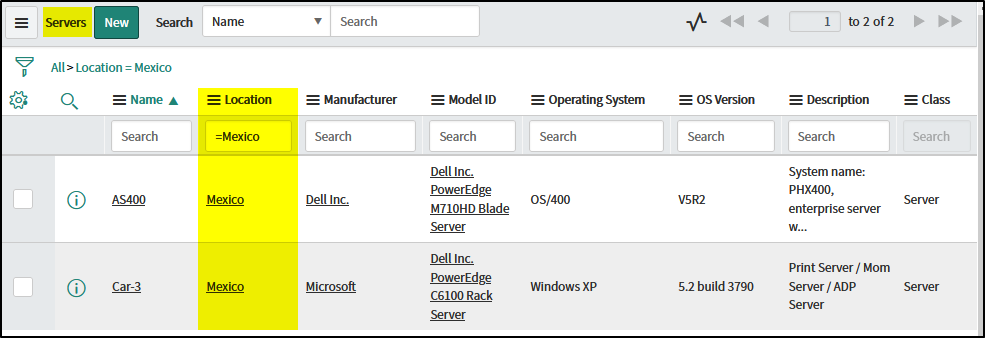

STEP #3 - I created some Test Data (2 CIs with Location = "Mexico")

Having NO Location selected in the "1st Rack" field, I can see ALL CIs listed in the Reference List for the "Affected CI"
As soon as I capture some Location in the "1st Rack" field, the Reference List for the CIs is limited to all CIs with the given Location!
