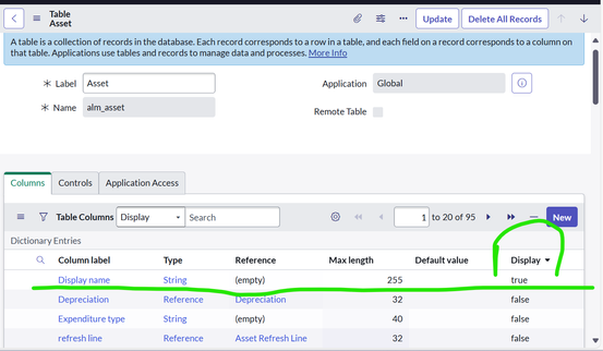

Hi @Nandhinisri ,
You can use only one attribute reference field globally, if you change it will effect everywhere. Refer below snip where Display Name is set as true for alm_asset table.
You can also refer this: Solved: Display User Id instead of User name to a referenc... - ServiceNow Community

‎03-19-2025 02:17 AM
not possible.
Whatever field is present as Display=true on alm_asset only that will be seen.
If you want some other field to be seen once asset is selected then make that field as Display=true so that it reflects.
Note: This will be a platform change and impact everywhere this table is referred
