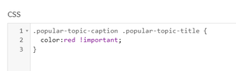

Press Ctrl+ right click on the widget
Go to instance in page editor
Add below to CSS section to modify color

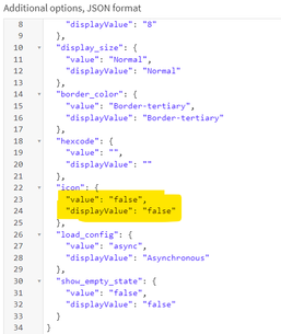

To hide the icon update below highlighted part to false
