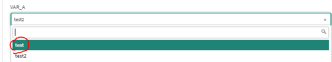

I am trying to remove a choice from a catalog item variable.
I have written a client script to remove the choices with the following conditions, but it does not work.
●Variable
Question
VAR_A
Name t015
●Question choises
Text test1(remove it) test2
Value 1 2
●Client Script
function onLoad() {
   g_form.removeOption('t015','1');
However, as shown in the image below, "test" is displayed.
How can I help you?
Best regard.
senon.

Few things to check
1) UI Type - ALL
2) Are you using correct variable name and correct choice value
Can you try this script
function onLoad() {
   g_form.removeOption('t015',1);

If this is in the Service Portal, make sure that your client-script has a UI Type selected of either All, or Mobile/Service Portal.
I hope this helps!

I did not know to set the UI type to "ALL".
Now, This script is working.
