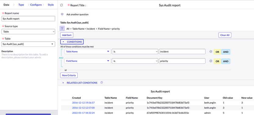

09-05-2023 02:10 AM
Hi @Mad3 ,
You can do this with standard reporting but would need to use the audit table data to check which inc got changed from P3 P4 P5 to p1 p2.
It may be reported via the sys_audit table
If you need some data from the incident record itself, a DataBase view will then have to be created and you may be allowed to report via that DB view.
I hope this helps !!!

09-05-2023 03:30 AM - edited 09-05-2023 03:31 AM
Yes i have suggested to create a database view and use that table for reporting ! i hope this help.. Kindly mark the question correct if it helped you...
