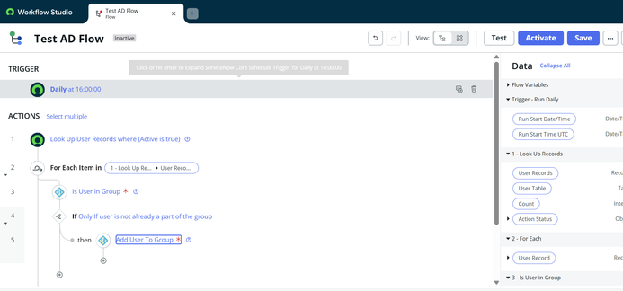

Hello @Alex78 ,
I just got a bit confused reading through your post — wasn’t sure if you were just outlining the requirement or actually looking for help in building the flow?
If you're trying to implement this in Flow Designer, then yes, it's definitely doable. You can create a flow that accepts input (User ID, Email, or Full Name), checks if each user is already part of the selected AD group, and adds them only if they aren’t already a member.
Assuming you're planning to trigger this from an RITM or maybe even as a scheduled/standalone flow, here's the rough approach:
  • Use the Microsoft AD V2 or even the standard Microsoft AD spoke to check if the user is already a member of the group.
  • If the result is false (i.e., user is not a member), then proceed with the "Add user to group" action — this can be done using the normal MS AD spoke as well.
Please refer to the image below and let me know if this is what you were aiming for, or if you're looking for something more specific. Happy to help further if needed.
