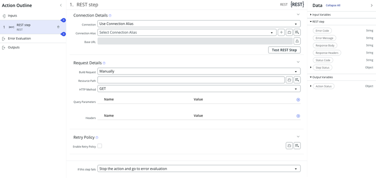

To do a REST API integration with flow designer components make sure that IntegrationHub is installed along with the REST Step Action component.
With that installed you can create an Flow Action and pull in that type of step
After selecting the Step then populate the settings accordingly:
Or you could use a script step and use a script to perform a REST Call
