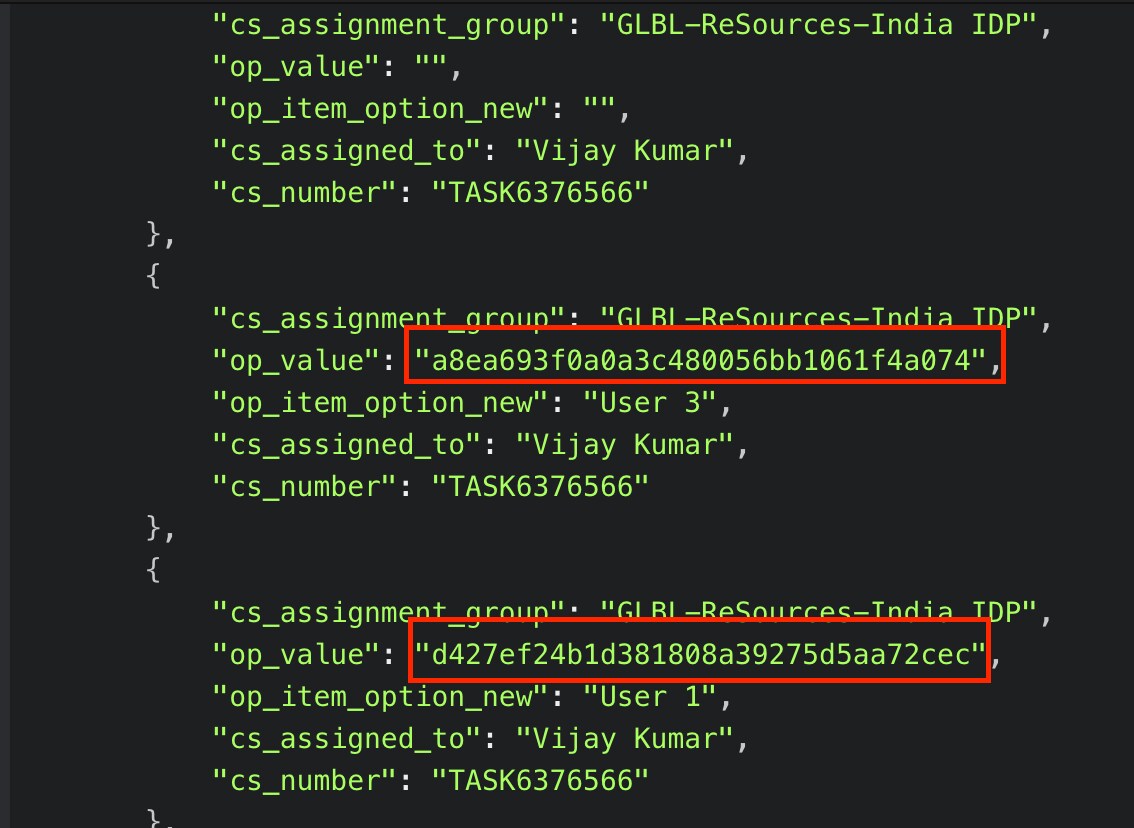

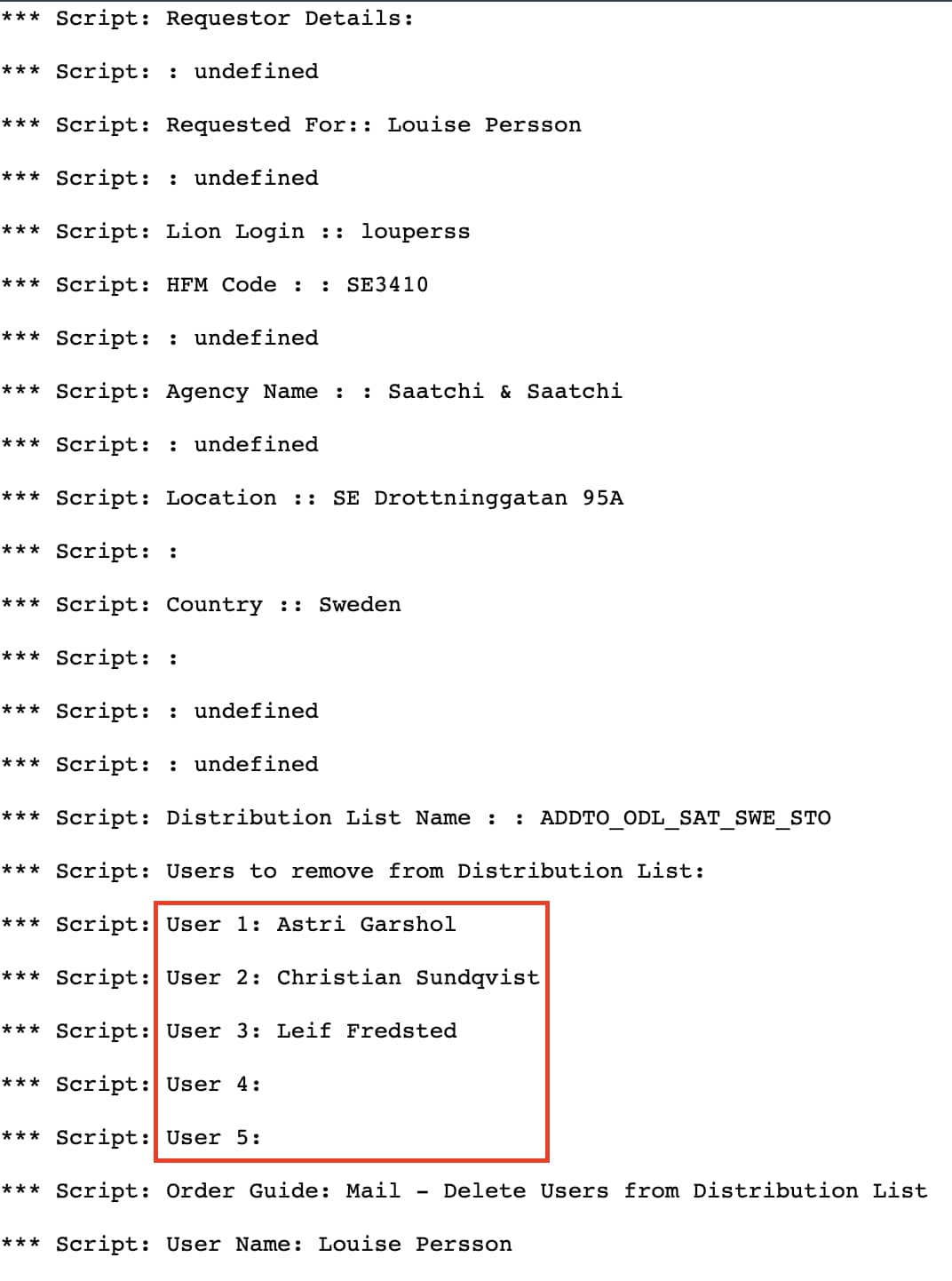

I've crated a Database view and created a table api of the table created. After applying sysparm_fields, i'm fetching variables on the catalog task and other task fields. The Road block is whenever variable is reference type then in response i'm getting sys_id as value, instead of sys_id we need the display value. I know we can do this via scripted REST API, However we want to do it via database view only, If any help can be done then that would be great.
I'm attaching screenshots of both the outputs that is from scripted rest and database view table api.

‎07-31-2019 10:31 PM
Hi Ankur,
I've done this, it didn't worked. If i'm using dot walking then that fields itself is not coming in response.
Value column in Options table is string type and i've set the display to true in dictionary as well, again didn't worked. sysparam_dispaly_value is already true.

‎07-31-2019 10:32 PM
Hi Ahmmed,
