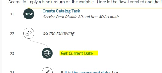

Seems to imply a blank return on the variable.  Here is the flow I created and the If logic I set up

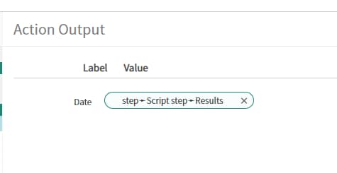

Thanks! I was thinking that was the final output of the action. Added the output variable
And added it to the outputs

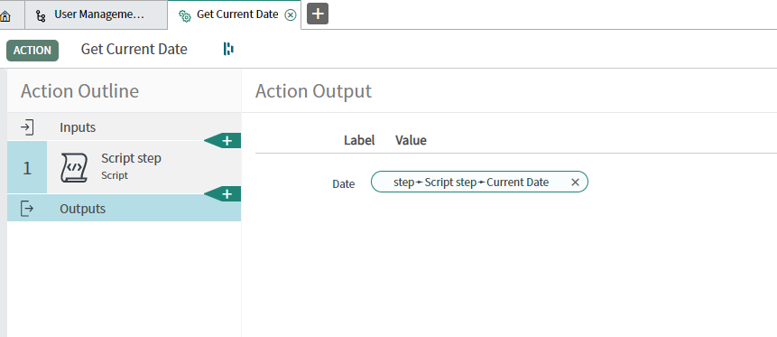

It got me a bit further. I now actually get an output
Updated the script step to look like this
Output is this
Any thoughts?
