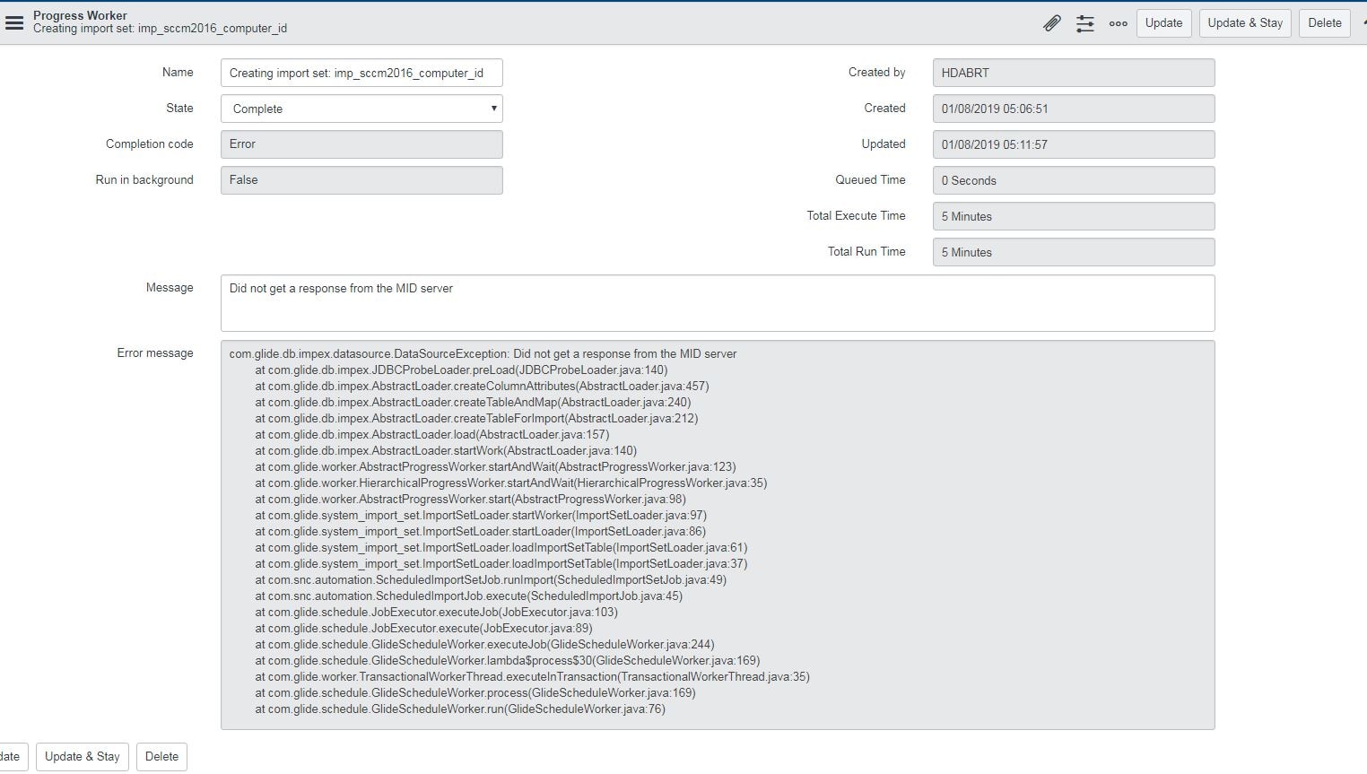

Our SCCM Integration was pulling in computers until about a month ago. We just noticed it's failing and don't know what might've changed to break it. When we execute the scheduled import it runs for the full 300 seconds and then returns the error "Did not get a response from the MID server". Other threads suggested looking at the logs on the mid server so those are pasted below. Any help would be greatly appreciated!

I was able to figure this out, the "Did not get a response from the MID server" message was being caused by the fact that we were running it with load balanced MID servers. Once we removed the load balancers, we stopped receiving the error.
