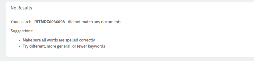

I'm facing an issue in service portal, when i try to search the request number in the service portal the results are not showing up, please advice further.Please find attached screen shots for your reference.

Is the search source defined for the RITMDC Table?
Navigate to Service Portal > portals > YOUR PORTAL RECORD
You need to add RITMDC table as a search source
To create a search source

02-05-2019 04:14 AM
Its working
Thanks a lot!
