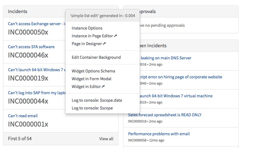

Hey Khamsone,
In order to do this you would have to clone the widget and edit it, there is no instance option to adjust this text size.   Just be aware that cloning the widget would be taking ownership of it.
If you do choose to go this route, you can simply add a class to the secondary field HTML span:
Cloned with nothing changed but css class:
See HTML Font Size Code for font size option, em is relative, you can also set it to a specific px or pt value.
Simple list Edit with class applied (The options below are not set exactly the same):
