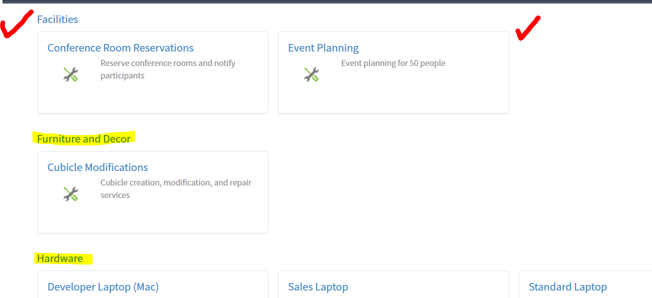

On our new service portal home page we want to have links which will take us to specific service catalog categories,
eg one for "IT stuff", one for "facilities", one for "business services" etc,
I've created an icon link on the home page with the type = category and then specified the category needed, eg facilities.
then I linked it to a new page which had a pretty picture and the catalog content widget thinking the link from the home page would set the specific category to display but it doesnt, so how do I get my "facilities" page to only have "facilities" catalog items?
thanks in advance!
(attachments shows icon link widget config from home page, and resulting page with catalog content widget showing all categories)

11-22-2018 04:53 AM
Can you add screenshots ? and mark what you do not want to see.?
11-22-2018 05:39 AM
11-22-2018 05:45 AM
I think this has something to do with your page design , looks like the widget renders all categories, will you be able to click a category and see only that , Whats the url when you see only a single category ?
11-22-2018 07:12 AM
hi,
so I opened the page and clicked just on the facilities category and got this URL
https://<instancename>.service-now.com/gs?id=sc_category&sys_id=d25201c8c611227a00667da13c6d33af
11-23-2018 06:21 AM
Hi - i managed to do this by changing the page I was going to to a clone of the sc_category page rather than the sc_landing page and then just did some tidying up from there.
Thank you to all who offered advice and help.
