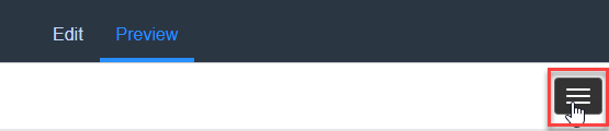

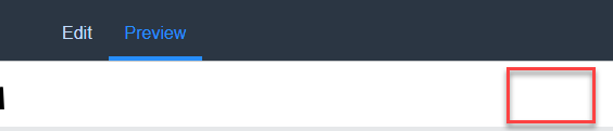

We are planning to make our Navbar background white.  However I noticed that when I you go to mobile view it is not showing the menu unless you hover over where it show be.
Mobile View:
After hovering over where the menu icon should be:
Is there anyway other then not using a white Navbar background that I can make the menu display?
Sure.  It's the second line in the html.  <nav class="navbar-inverse">
Change the class from navbar-inverse to navbar-default.
