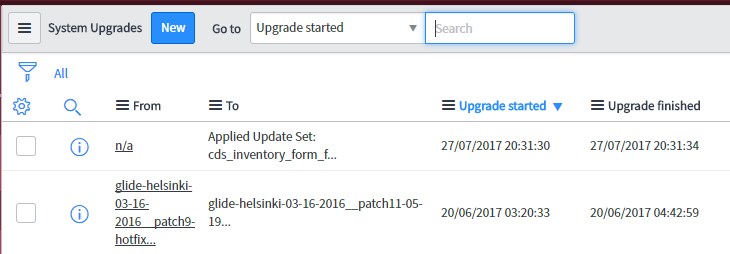

PRB714724 is already in place for the issue. This is fixed in Helsinki patch 10. Could you confirm the version of ServiceNow in use.
‎08-30-2017 07:50 AM
‎08-30-2017 07:53 AM
You can go through link ServiceNow KB: Multiple instance of -- None -- appear in Service Portal dropdown (select) boxes when...
Even if that does not help get a HI Ticket logged in.
