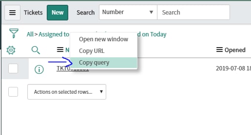

So i think your problem is just filter, i recomend filter on the plataform:
Bellow follow the step by step:
1 - type yout table on search like this (sys_user.list)
2 - apply a filter as you need we have the dynamic as showing on the image bellow
3 - the trick is copy the query and apply on the widget
Apply the query on the simple list and everything will work!!
