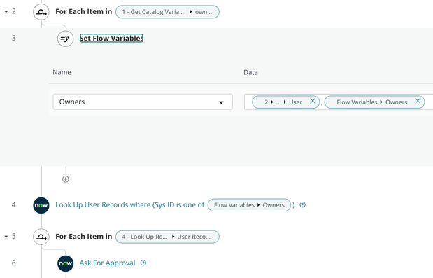

The easiest way to get the "unique" users is to do a simple "Look up records" Action. However you need to convert the MRVS into a single line, you can do this by adding a new flow variable called "Owners" of type "string".
You need to iterate over the MRVS and concatenate the approval users.
Please check out the screenshot below, and note step 3.
In step 5 you iterate over the now unique sys_user records. To do the approval concurrently, you would need to create a new subflow which only contains the approval (and probably a syncronization variable so you know at some point that all approvals have happened). This subflow can be called with "Wait for Completion = false" so they run in parallel.
