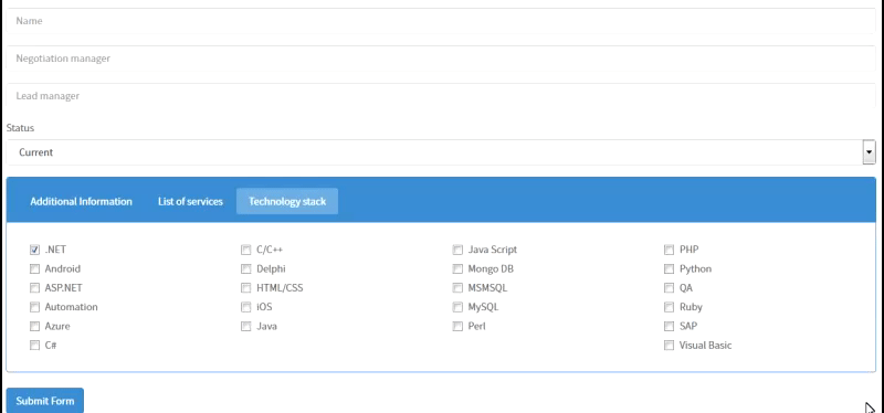

Hi guys,
I created a custom form (similar to system form) and I'd like to add records to the table through my form from Service Portal Page.
How can I do that?
In other words, submit button should do the same thing as a submit button on system form.

Thanks for your input Phil.
Just to make sure I understand your answer:
I created a page with widget which consists of a form with submit button like this
So in order to submit this form to "Customer" table which I've created before I need to use Record Produces or UI Policies?
Why I can't use client script Glide Record and submit all the form value using it?
