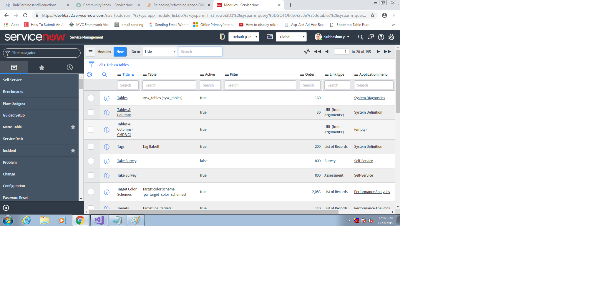

hi
my instance not showing tables module but tables & columns module showing.
when i type sys_db_object it is showing the list of tables. then i added that one in favourites.
Please find the below attachment.
TIA

hi
thank you for your reply but in sys_db_object.list contain the tables bot the table is sysx_tables[sysx_tables] .
i modify the that table activ false to true but it is not showing the tables.
please find the below attachemnt.
