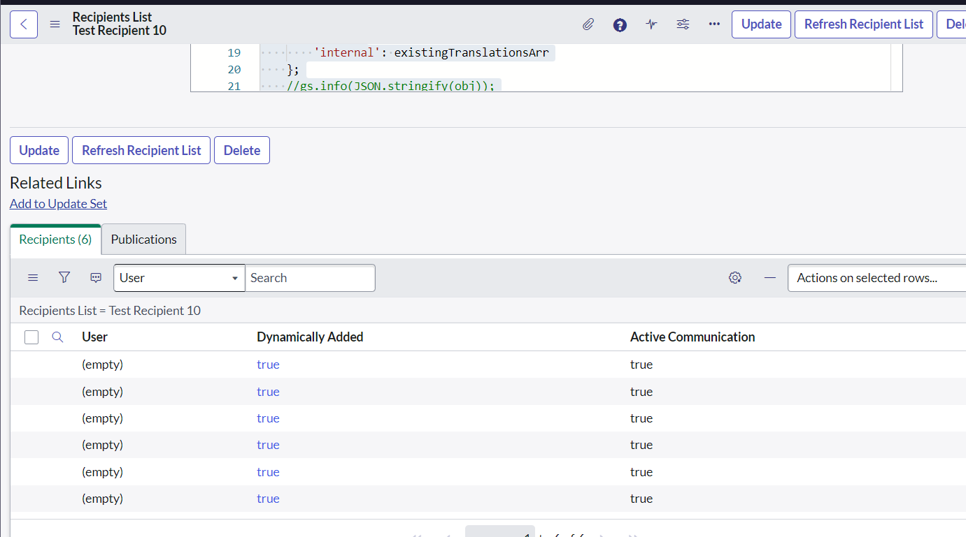

The recipients which this script is ultimately adding is also attached in the attachment- which seems to be blank users, and also I specified 10 rows, it brings 6 rows. Not sure on that part as well...

I changed the 'Type' of the Recipient list record to 'Contacts' and also updated the previous script json type from 'internal' to 'external' and then the script was able to populate the recipients.

Script is working fine and list is also loaded correctly see the attachments.
Please check in user table if you are having the correct data that you are using in your query.
