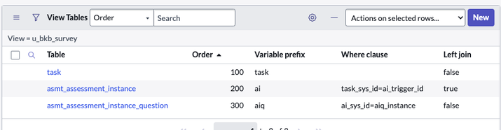

I have create a database view between 3 tables to have all the tickets with all the states append to survey result but i am just getting tickets that in state closed or closed complete.
here is the database that i made

Only tickets in those states have a survey, so if you want all of the tickets regardless if they have an assessment instance you need to make Left join = true on the task table entry, and switch the Where clause to task_sys_id = ai_trigger_id

Hi @Brad Bowman
i have done what you tell me but when i filter with instance is empty i get no result so i only have the tasks with a survey and i have checked the left join in task

I would start with the task table since you want all records from that, so more like this:
ā10-18-2023 06:28 AM
@Brad Bowman sorry but i still don't have tickets without instance survey or instance survey empty
