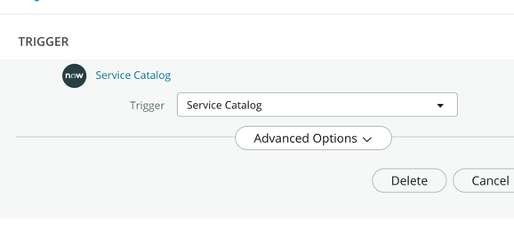

Hey @Meloper ,
You can select the Trigger as 'Service Catalog'. It will run only for your Record producer whenever it gets submitted/ordered.
Hope this helps!
Kartik
01-13-2023 04:34 AM
i tried this but it seems to be, that it is not working.
I i create a new case, i have to select an hr service and maybe because of that there is the RP linked, it runs also the flow?
01-13-2023 04:35 AM - edited 01-13-2023 04:39 AM
yeah i checked again, the flow is running also.
if i click on test,
i can only select ritms no rps, so i guess its only IT related
