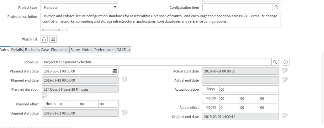

Can you compare Planned end date field type with the Planned start date ? Also, share the screenshot of your Planned end date.
Try with different date formats maybe ?
Is 2018-09-01 08:00 present in your excel sheet ? If so, is that the value of the first row ? I noticed that your format is YYYY-mm-dd HH:mm:ss. Try changing that to remove ss since your planned end date doesn't have ss in it.

Thanks for reverting. Actually, the date/time format is YYYY-mm-dd HH:mm:ss on snow indeed. Hence I'm following the same format on my excel sheet and it's just the planned start date filed that's causing the problem for strange reason.
Here's the screenshot as you requested.
