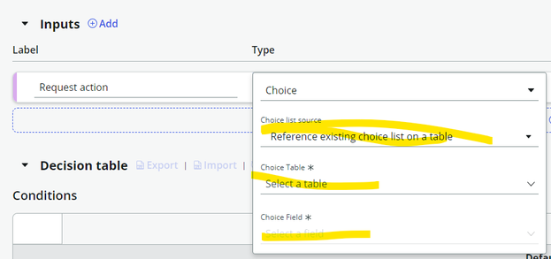

I want to use a decision table in my flow to determine what catalog tasks (and their assignment group) should be created based on the data that was selected when a request is submitted.
The catalog item uses a select box to determine the "action" to take, I want to use these choices as the input to the decision table but I don't know what table they are in so I can use them as the input choice list in a decision.  Ok, I admit this is confusing.

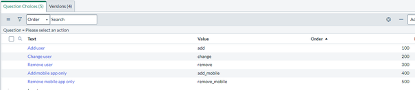

On the catalog item, the Action variable is a select box and these are the choices:
In the decision table, I want to use the question choices as the input and reference the variable choices so I don't have to maintain them in two separate areas.  What table to I select?  How can I be assured the correct list is selected since I only see one field as an option?  There is more than one catalog item variable named "Action".
