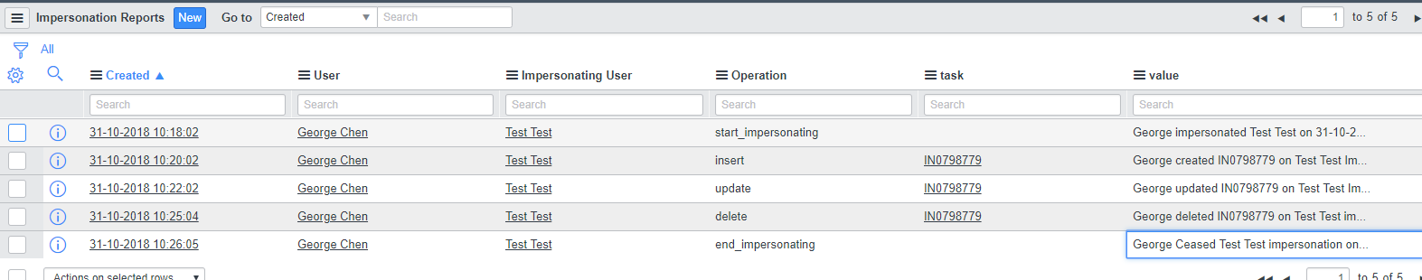

I've come to take a challenge to build a reporting in system with user impersonation which will be used by Management to use in case any reasons may raise.
I have some investigation from ServiceNow Doc and noticed a sys_property can be enabled to enable the logging, however, the OOTB log appears to be very basic (in syslog table),
This is a concept only screenshot I wish to build
I was wondering if anyone has built something similar or known any plug-in, that would accommodate this sort of reportability?
Thanks in advance.

10-30-2018 08:22 PM
Hi George
Whenever someone imporsonate servicenow event engine fire a event impersonation.start and when the impersonation end then fire another event impersonation.end.
You can write a event script and setup a table to capture the details and then you can setup a report on that
-Harsh

10-30-2018 09:36 PM
Hello George,
The best approach instead of BR would be script action. Script Actions are server side code which runs whenever an event triggers.
https://docs.servicenow.com/bundle/london-platform-administration/page/administer/platform-events/reference/r_ScriptActions.html
Ali
