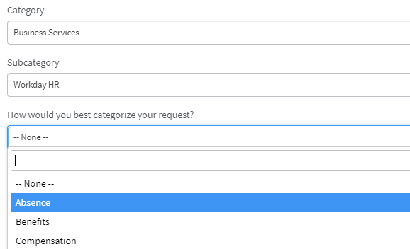

Hi, I created a variable set used on 3 Catalog Item forms that has 3 lookup select box variables that pulls in the information from the Category, Subcategory, and Components from the Incident table. I have been asked to autopopulate on 1 of the forms the category and subcategory with a default value. So in a client script I created an onLoad script that will populate those fields.
On the component field, the user will select the component that fits their request.

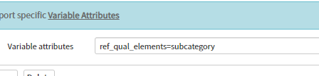

And I have the variable attributes req_qual_elements set to subcategory

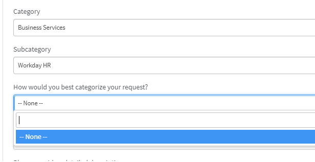

The problem is that when the form loads, it populates the category and subcategory fields as it should, but the component fields does not display the list based on the filter of that field.
If I manually change the subcategory field, then the list drops down.

No problem. I think the onLoad does not trigger the Advanced reference qualifier to recalculate.
You have 2 options:
- Duplicate the variables and use the duplicates with default value for this form.
Or
- Create a Script include that returns the Reference qualifier based on the subcategory.
09-10-2020 02:53 PM

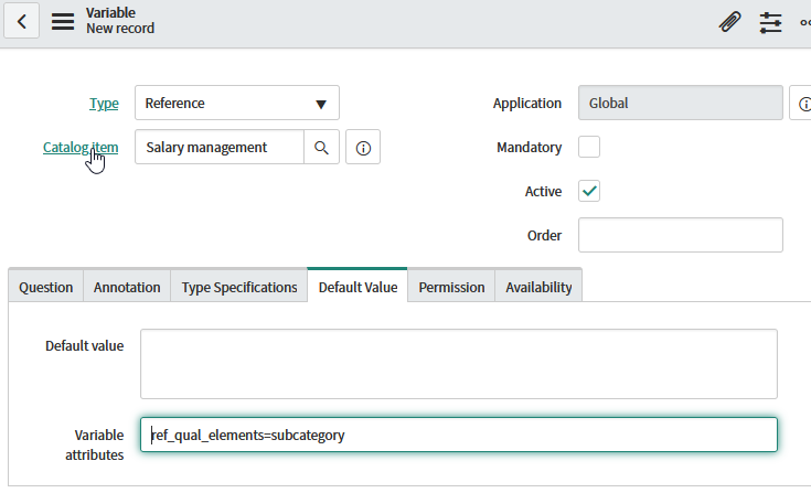

Can you add the Attribute ref_qual_elements to the variable and try again?
For example: ref_qual_elements=subcategory
| ref_qual_elements | field name list, separated by semicolons (";") | any reference field with a reference_qual field | Specifies a list of fields to be sent back to the server in order to get an updated reference. |

09-18-2020 05:41 PM
You added this to the "How would you best categorize..." variable?
