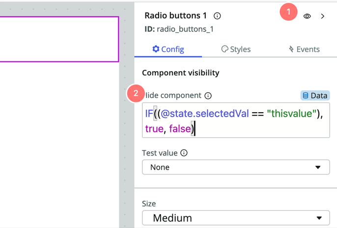

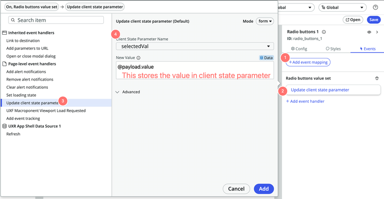

Okay here is how you can do it. In UIB you get events which are triggered by components. Radio button component also triggers an event which you can use.
1. Create a state parameter to store the value selected in radio button. Lets call it selectedVal.
2. Go to the radio button events and add an event handler for event "Radio buttons value set". Follow steps shown below.
3. Now, go to the container or component you want to show/hide based on this value.
4. Click on the hide component property and bind the value like below. Here you are hiding the component if the value equals to thisValue. Change it as per your need.
Thats it!

04-01-2023 07:13 AM
Thats it!
