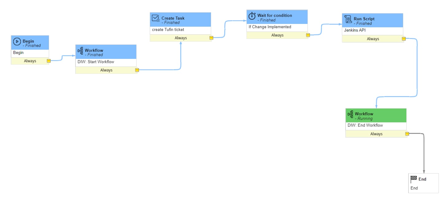

ā03-29-2022 06:37 AM
Hi Subrahmanyam,
Thanks a lot - It worked this time.
I just updated the "Wait for condition" as you suggested with the "return" option (instead of answer = true) and first tested it with that update only, and it finely did the job and workflow continue.
Here is my workflow trace status (finely):
WOW, Thanks a lot for your great help, appreciating it a lot!!!
